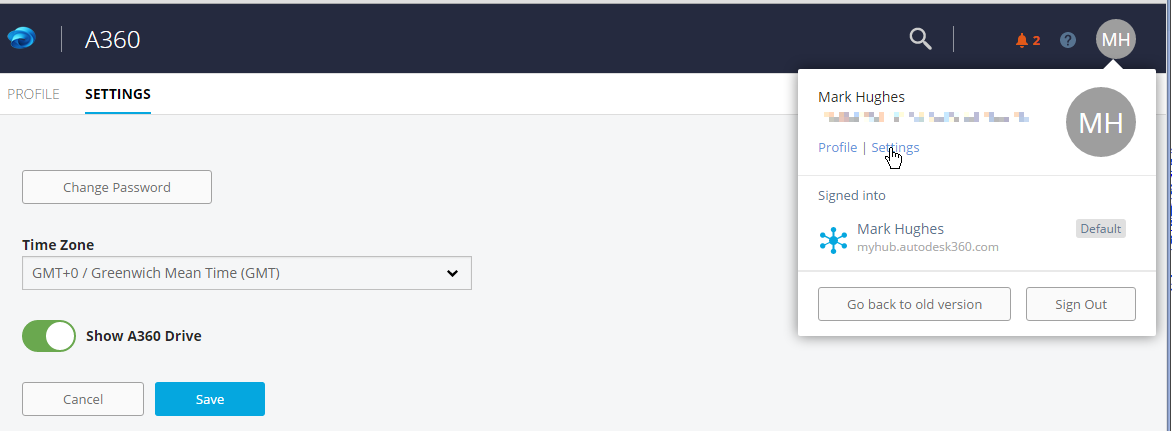

Just a bit of info for anyone using the new Dashboard. You have to enable A306 in setting to access your CAMPosts, CAMTools etc.

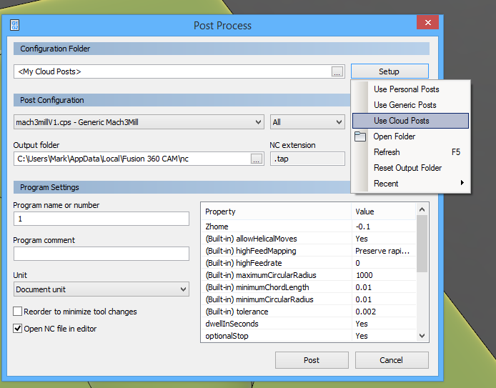

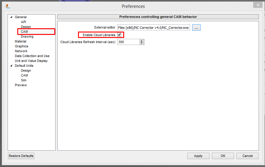

Just thought I'd update how to load a post to the cloud.
First enable cloud posts in preferences.

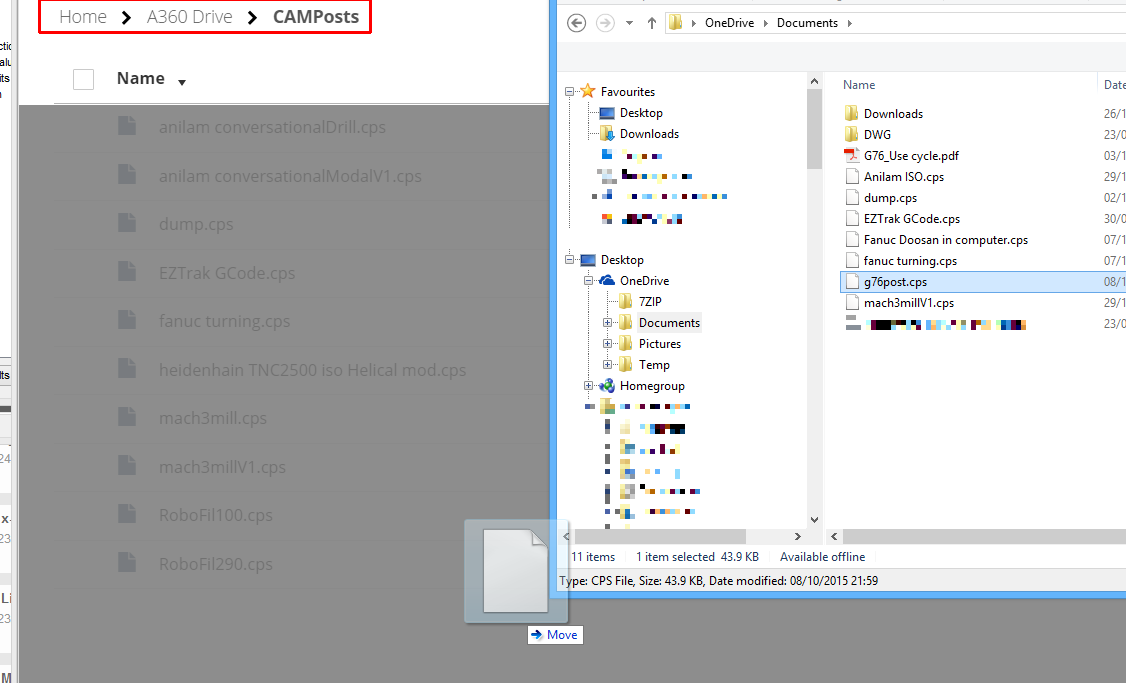

Then open Dashboard and enable A360 drive as show in the post above. Open A360 and click through to the CAMPosts folder, with the CAMPost folder open just drag and drop your post.
After a few minuets or seconds the new post should show up in Fusions Cloud posts.
