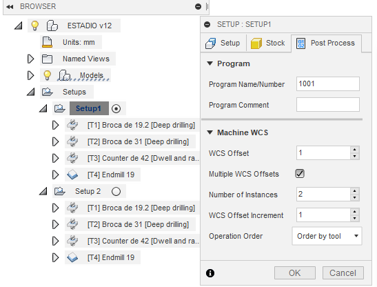

Hello
I have multiple setups with different WCS and multiple tools. My problem is when I post process it with a Fanuc/fanuc, in the first tool I get the offsets like:
T1 (tool 1)
G54 ....code
G55 ....code
G56 ....code
G57 .....code
Then when the tool changes my offsets are like:
G56 ...code
G54 ....code
G57 ....code
G55 ....code
I want when every time the tool changes it starts from G54, G55, G56 etc
Any way to do this?? Thanks

I'm not at all seeing that with the included Fanuc post processor. By chance, are you using a modified post?
I get:
G54 ....code
G55 ....code
G56 ....code
G57 .....code
And that's after every tool change as well.
