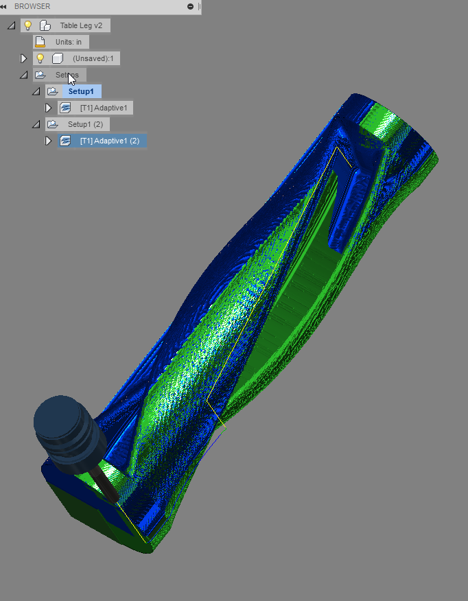

Do you know you can select all the setups or just select the setups folder and simulate. This will not help with rest machining but ate least you'll see what you'll get.
Also have you tried setting up tool orientation in an op. Do you have a 4th axis and a post setup for 4 axis work? See attached file. If you are using the standard version of Fusion you'll need to activate tool orientation in your preferences under preview.
Sim with tool orientation. Looks like you might need to set the depth a bit deeper.

I had tried right clicking on the setups folder before, but your post made me try highlighting it and going to the actions pulldown, and selecting simulate there.  Sure seems like it should be in a context menu on the setups folder.
Anyhow, that at least lets me see what I will end up with. Still will be cutting a lot of air, but I can live with that.  Maybe the 4th axis stuff will fix that, I haven't had a chance to try it yet.
