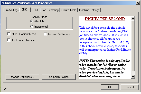

My local Multicam guy says that IPS can be toggled in the Jobserver configuration, so I just switched mine back to IPM and we'll see how it goes. I haven't tested this yet. Here is a screen shot. I just unchecked the Inches Per Second box that was enabled by default. It might be of interest to someone with the same issue.

ICanSpinIt
@randyT9V9C ,
     I have tried that edit with no luck, at least for the latest post from the HSM library (06/05/20).
However I did make changes to the post where I did get a successful conversion.
At every line where there is:
feedOutput.format(feed
       -Change to-
feedOutput.format(feed/60)
writeBlock(gMotionModal.format(1), f);
     -Change to-
writeBlock(gMotionModal.format(1), f/60);
I believe it was on lines:
408
435
439
443
492
509
527
There are prior jobs on machine for production that I don't have to time to correct right now so I cannot switch the Observer config, so thank you for this post!
