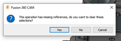

I get a red error and the toolpath cannot generate when I get the "this operation has missing reference, do you want to clear those selections?"
Normally I click no, go and edit the toolpath and correct it and it is fine. Now since the update it will not generate a toolpath unless I click Yes even after I have reselected the missing references.

So the workflow I follow is this:
Solidworks model imported with Autodesk Connector. I update the solidworks model so everything needs regenerating. A few toolpaths may lose references and as such I get the error in the original post. Not a problem normally I select "no" manually reselect them and it's fine - not any more. Now I get a red warning error (I will look out for it next time and screenshot the exact error).
If I go edit again and click "yes" this time then ok the toolpath it generates fines so it is saving the new references I select it just will not let me regenerate it unless I click "yes".
