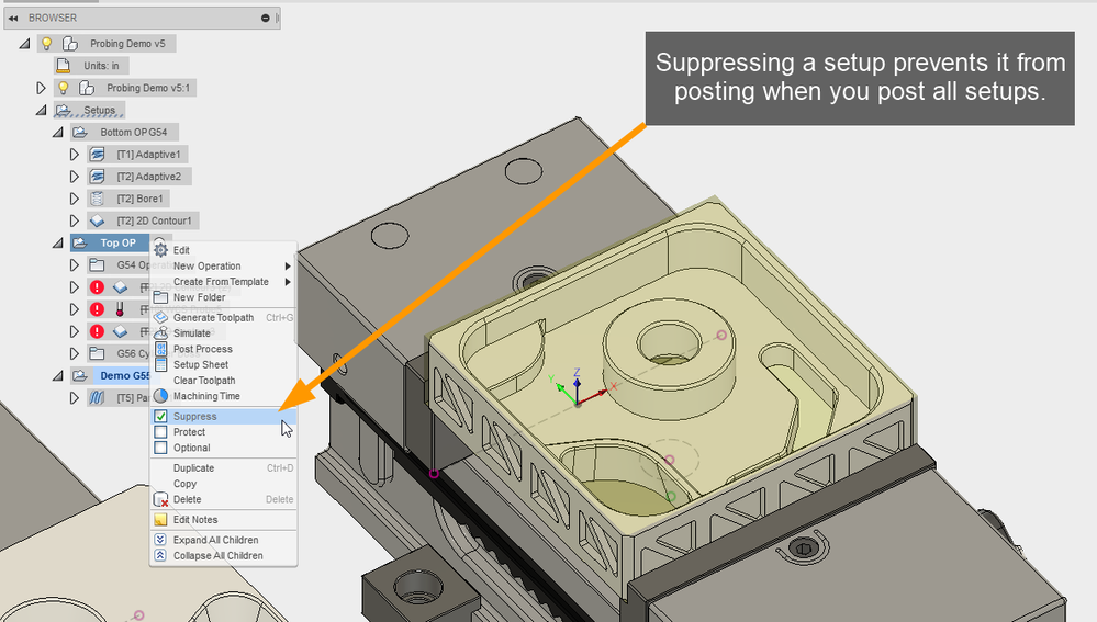

If you find yourself constantly having to re-post a long list of setups and don't want to manually select them all, just suppress the setups you don't want to post like so:

Suppressing non active setups isn't a bad idea, thanks for the suggestion.
