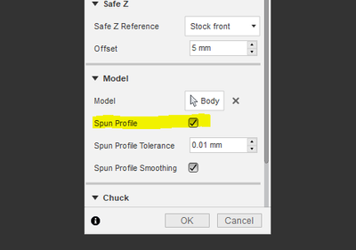

Wrong mill turn operations. error in Mill-Turn ğperations. . While determining the way in turning, it also processes the surfaces to be milled. I think some features suppressing when turning or milling.

You need to select 'Spun Profile' in the Setup dialogue to make Fusion respect the outer profile of the part when turning.

Thank you.
