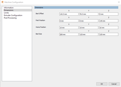

So we got the automatic code conversion working but regardless of how we convert the gcode (either manually or through the script) it doesn't print in the correct location. If we import the STL to MakerBot Print and create the x3g file that way it works perfectly.
We're using a MakerBot Replicator 2 and I double checked the settings to make sure that was the printer selected in both Fusion and GPX.
Any idea why this is happening?
Message 13 of 19
serge.quiblier
Hello @c.niven
It more than likely caused by an error in the machine defnition file.
We have values defining the location of the build plate center relative to the machine origin.
There is probably an error in the definition.
I will ask some colleagues about the material used to prove out the post.
Can you copy the machine configuration you are using in a personnal folder, then edit it for checking this:
If you have different values, tell us.
You can test by settings X Y Z center to zero also.
Please give us feedback on what is working, so we can fix these values if needed.

c.niven
Bed offset looks fine.

Message 16 of 19
pendlei
I used these settings and the print is in the right location
