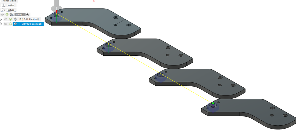

I am trying to write toolpaths but when I CHOOSE AN OPERATION ,i GET SETTUP ERROR THAT one or more features are missing?

Hmm...not on the file you shared:

I get the same as @seth.madore generates toolpaths OK here.
Just a question, are you referring to the error shown in the image below ?? If so that is normal, it goes away when you OK your Operation.
 Do you have the "Browser Icons" enabled in your "Preferences", if you disable that you won`t get those errors.
