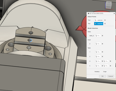

JaykReed83
I'm having this exact issue. The simulation is showing my spindle head like two feet above the tool during simulation. Any updates on this?

I'm not sure if this is the right way to do this. Let me know if it doesn't work.
Message 8 of 10
a.laasW8M6T
It's not a problem with machine simulation, you just have your machine setup incorrectly.
You can see here the Tool Attachment point is on the Table rather than the spindle face
Spindle attach should be here:
You also had the part attachment point incorrect but that is less important, it should probably be here:
If you fix that is simulates correctly.
Andrew Laas
Senior Machinist, Scott Automation
Message 9 of 10
JaykReed83
Thanks! I made the adjustments you suggested. It definitely fixed the issue with the spindle head being way above the tool during simulation.
The part attachment adjustment helped too. Ive been having to manually move the part location every time i update anything. So, that helped too.
However, I'm still getting the "Machine Simulation does not currently check for machine collisions" warning. I'd really like that to work since this 5ax trunnion is brand new and i really dont want to lose my job for crashing it. lol
