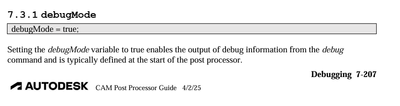

Hello All,
I'm currently utilising the Mach 3 Post Process for my NC files on my Bridgeport CNC, is there an option to turn on a "Debug" mode in the post process like some of the other post processes have?  If so, can someone assist in guiding me to that option?  I can't seem to find the line with that option in this particular post.
Thanks, Mark
259 Views
1 Reply
Reply (1)
jodyF8L9L
I can't seem to find that particular option in any of my posts, but looks like it's an option set at the beggining of the post. You might have to copy/paste and play around with it. Here is the post processor training guide if you don't already have it: https://cam.autodesk.com/posts/posts/guides/Post%20Processor%20Training%20Guide.pdf
Chapter 7 has to do with debugging.
Not sure if that means to set a post property, or to simply declare that variable in the beginning of the post, though. And I could use the exact verbiage/syntax as well as I create many posts.
