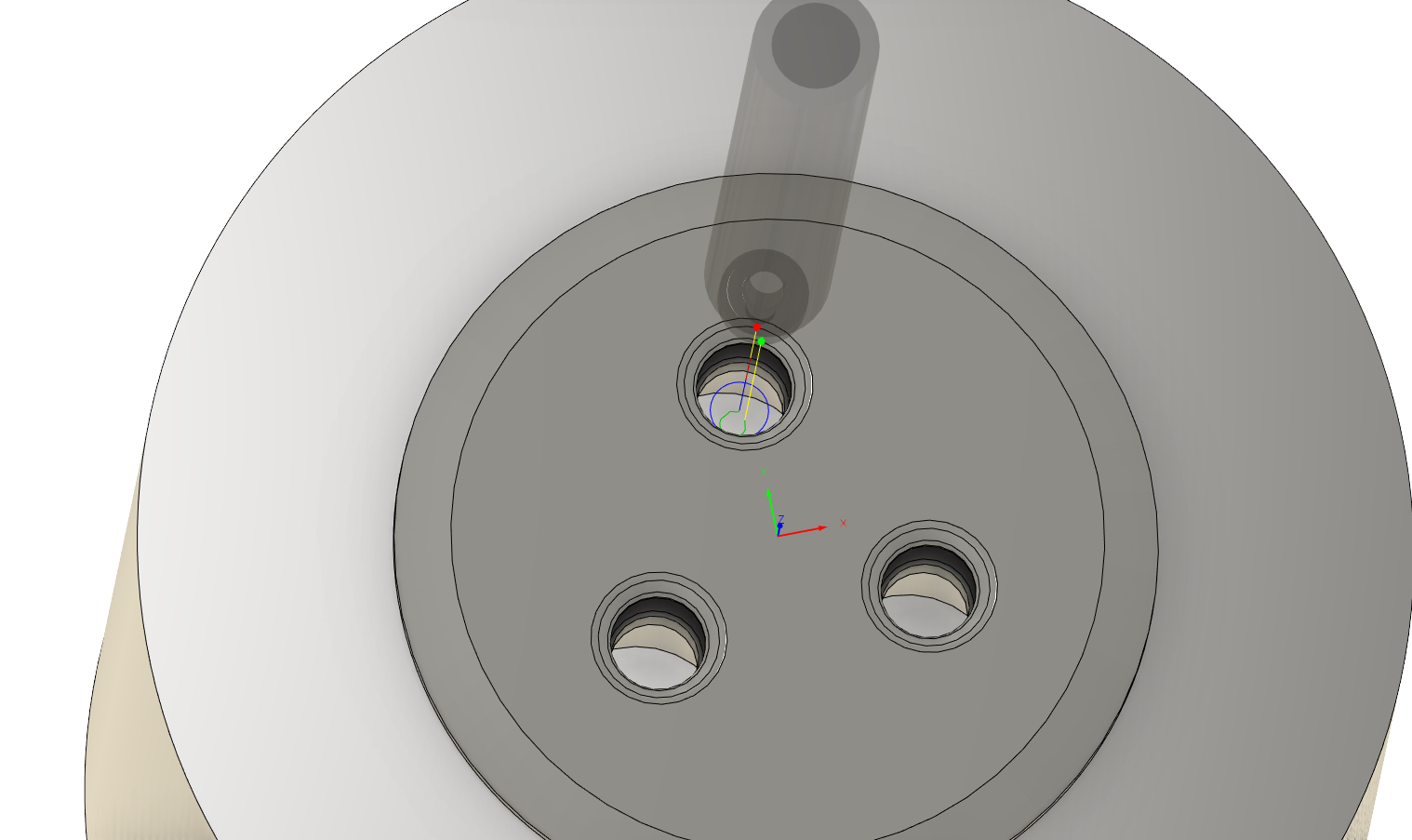

afternoon all
looking for help to find a tool path that lead in the drill hole and out same point  using tool comp for my undercut groove with out doing it mainly once program has been posted to machine
in setup 1 program attached any help be grateful with solutions 

Thanks for posting! In these scenarios, i'd usually suggest using the 'circular' operation with the 'lead to center' option ticked. However, that operation doesn't support form tools. For your case, I believe these settings will work (please double check them):

it worked and with form tool also
i also managed to do another way by creating a multi sketch and then using trace cant seem get my screen cast to share public but videos attached
show the circular working with my form tool and the form tool using trace and the sketch how i drawn it to work also
thanks for the tip and help with be used very much now know can do that
