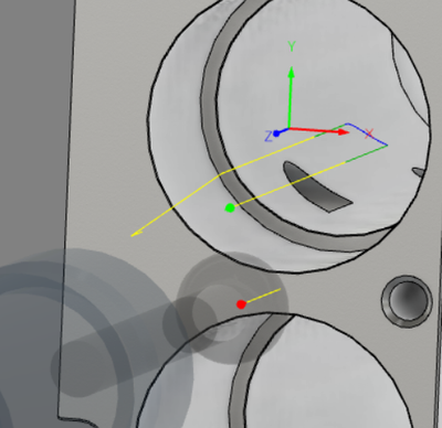

Happy Saturday! Got a tricky deburr question for those who like a challenge. I machine quite a few parts that have intersecting holes. On center is usually no problem and most circular/elliptical intersections I figure out...however, this one has me stumped. Got some flat bottom holes and some double intersecting holes (football shaped) that need a light edge break.

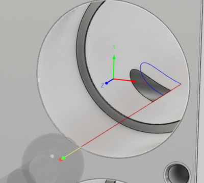

3D contour is not doing it for me and neither is Trace. 3D contour looks good, but gouges the part (randomly) and takes a while. What I really want is a Trace style path that will lead in/out in X/Y, run the traced outline of the hole and retract. Tool Comp on center is the only way the path looks okay but with no leads. If I put comp on, it's all weird. See below for some pics and I attached a condensed file a what I'm dealing with. Any help appreciated.
Trace (No comp/No Leads):
Trace (Comp On...inside the part!)

So I model a shallow chamfer on the part and use the Flow toolpath
Short Video on how i do it:

Thank You! I really appreciate you taking the time to post a detailed video with my part.
I had to play with the tolerance some and use a smaller lollipop on the D shaped holes, but this solved my woes of having to flex hone or otherwise hand deburr these parts.

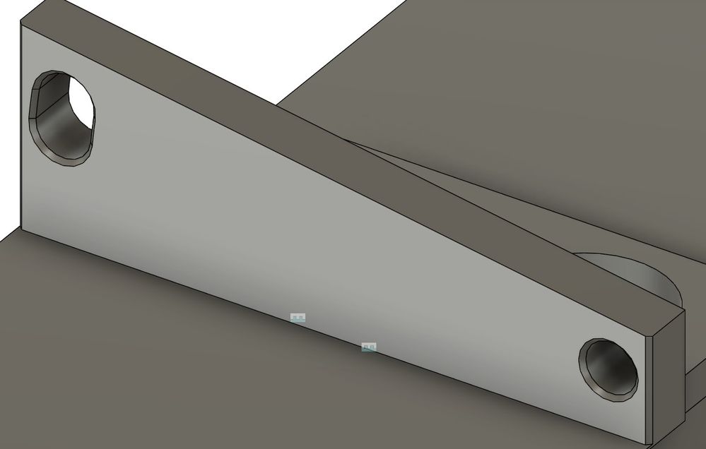

I would like to bump this to the top of the board. I have tried to get this to work with my parts and I can't seam to get it to work. The interface for Flow seams to have changed enough that the above video is not useful. At least not of me. Screenshot 2025-03-26 142200.jpg

Yea that was with the OLD Flow toolpath which is technically still available but I wouldn't recommend it.
I would use Geodesic(set to blend) now, but I don't think you will be able to machine the 45° chamfers you have modelled, note how in My video I model them at a shallower angle.
With geodesic you can limit the number of stepovers to 1 if you only want to do one pass
If you are still having trouble you can upload your file here for us to look at.

I tried that geodesic path and it looks like i at least get a path that pretty much makes sense now. I tried setting the path type to blend under the geometry tab but it gave an error. No problem though this will get me another 80% closer.
