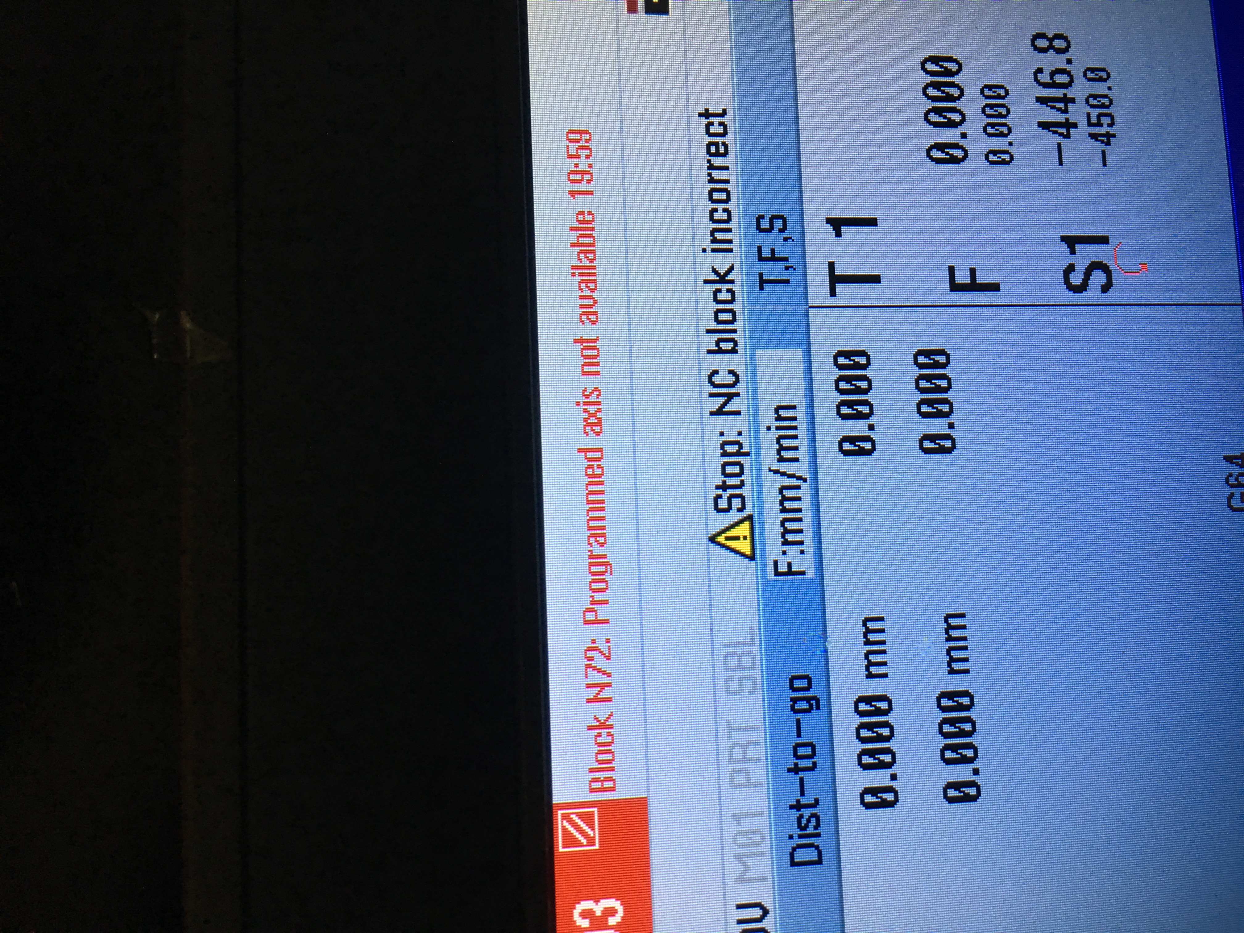

I have an error hoping up on my machine programmed axis not available.I am trying to run a drilling cycle in fusion lathe all my WCS look good i have attached the code, have no idea why its doing this is there something I'm missing for the drilling operation like tool orientation

Well, tool orientation is not needed if you are drilling in the same orientation as your Setup, which you are. However, turning off tool orientation produces no difference in posted code. I guess the question is; What does your machine want to see for a drilling cycle? Are the posted values correct, but causing an issue? More exploration on your end as to what is causing this issue (in the code) is needed, I suspect. Once we determine what is triggering this alarm we can start looking at the Fusion or the .cps file and determine where to go from there.
Block 72 is your drilling cycle:
N72 CYCLE83(5, -1, 5, -28, , -7.25, , 0, , , 1, 0, , 6.25, 0, 0, 0)
What does your manual or other programs show for formatting?

Yes you are absolutely right its the same for Siemens I am peck drilling so its Cycle 83 the formatting in my manual looks the same as posted code

I managed to get the drill cycle working I had to put a G17 in there, also do you know how I could add a variable in my PP to let my turret do a tool change at the home position,I have a few long tools and the home position setting in the work setup is not enough clearance for me before it hits the limit switch in the Z so  to move up in the x as well would be ideal

yes just add a G17 to G code just before the spindle turns on

All working perfectly now, just swapped out the G18 for a G17 in the intro to the code. Now all drilling cycles work with no effect on other operations.
The thing that confuses me is why? If its a turning post why don't the cycles work in XZ ?
