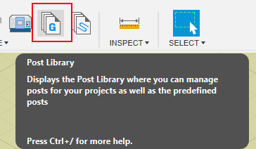

Open post library:
Open "Fusion Library";
Select "Setup sheet" filter on right side;
And copy "Setup sheet (html)" into your local library.
If you are using Excel setup sheet you can copy it as well.
Fusion will not use setup sheet from local library, so you can immediately delete it. It is just for caching online post.
