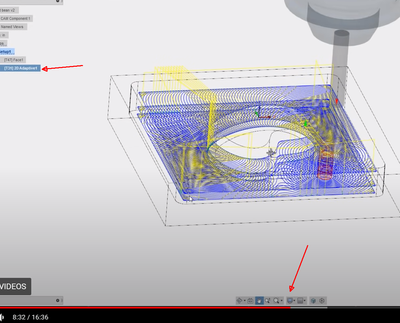

How may I achieve this type of view while doing a simulation in the Manufacturing Environment?  Setting Opacity to zero in the Design Environment does not achieve this appearance in the Manufacturing Environment.
Also, what would this be called so that I could search for this in the product documentation? Or, could you provide a link to the product documentation for this?
Wire Frame VisibilityWire Frame Visibility

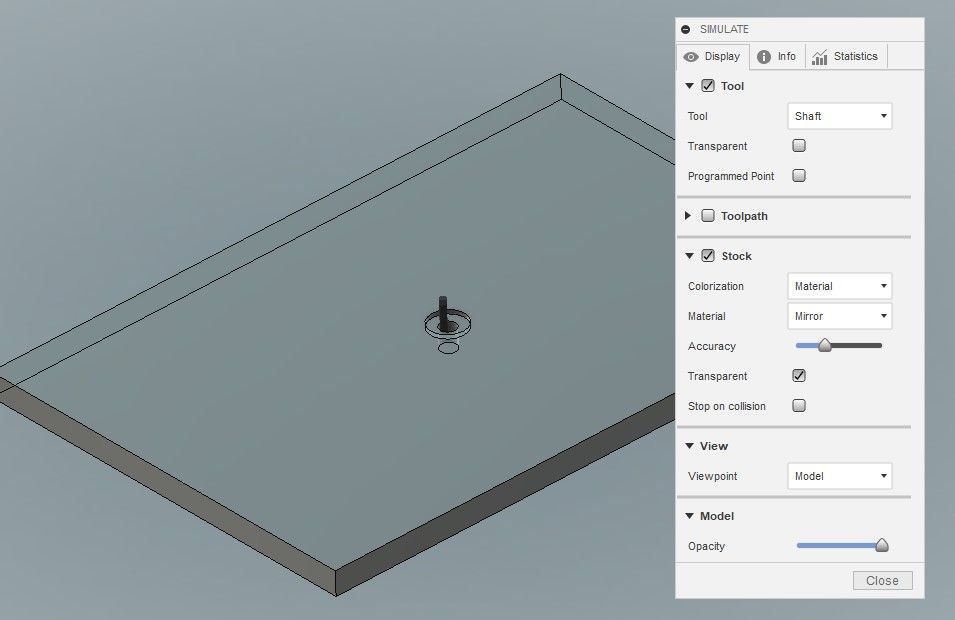

engineguy
@Inspections_JCH
Hmmm, you might get a little closer to having it clearer by using the "Colorization" and "Material" options, pretty limited choice but it helps a little, see image below.

This link is to a time stamp where I saw the image, but everything before it sorta flew by so fast that I am unsure how he arrived at this. https://youtu.be/Do_C_NLH5sw?t=505
Message 8 of 17
HughesTooling
He's not running a simulation at that point. You can see there's no play buttons at the bottom of the screen. The toolpaths are showing because the op is selected in the browser, display is set to wire frame from the bottom toolbar.
