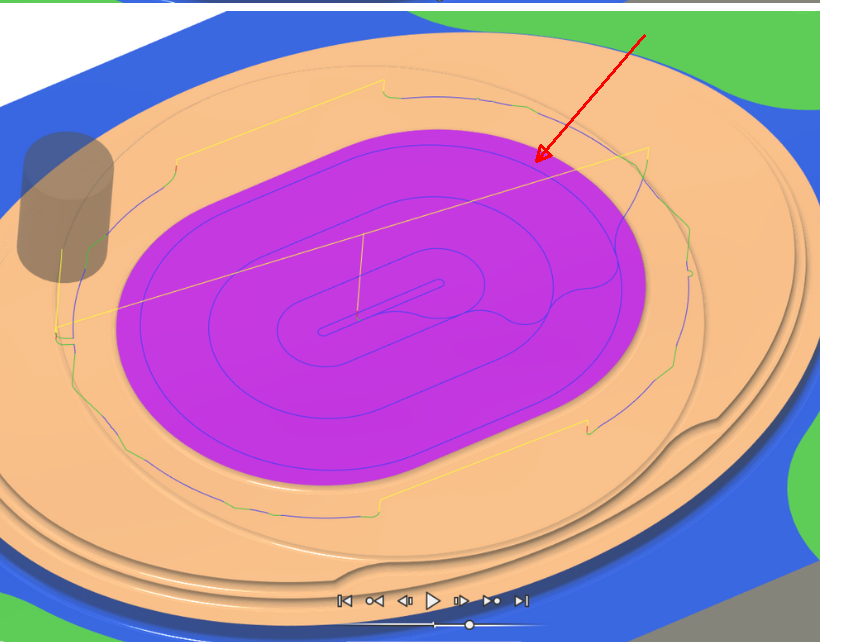

Message 21 of 27
HughesTooling
@kieran.gill wrote:
Images below show Inside-Out with and without Optimized Open Pocket machining
Sorry. I missed this post. Looking at both of those toolpaths, they are both quite bad! In both the outer pass would be cutting air as the previous pass would have removed all the material.
Anything outside this pass is not going to cut anything.
@kieran.gill Not sure who your last post was to or about, was it this and the outside in problem?
Thanks Mark
Mark Hughes
Owner, Hughes Tooling
