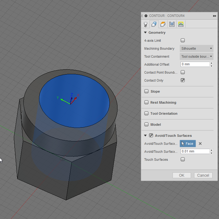

I'm sitting by the machine trying to perform the last finishing past but get error messages on the last step, a 3d contour.
Can anyone help?

There's 2 reasons it doesn't work.
1. You have Tool Containment set to Centre. If you want to machine the outside you need it set to Tool Outside boundary.
2. You have Rest machining enabled with an adjustment offset of 0.5 and there's only 0.3 from left from roughing. Personally for a finish cut I'd turn rest machining off.
I've got to ask why are you using 3d finishing on a part like this, you would be better off using 2d contour you'll get a far smaller file. See attached file setup2 for another way of machining the part.

HughesTooling
The boundaries behave a bit differently with 3d ops, with it set to centre the tool will not fit between the outside of the part and the silhouette offset by the radius or the cutter. If you want to stop the op machining the bore use Touch\ Avoid surfaces, select the hole surface and make sure touch is unselected.

maker9876
Yes that makes sense and the avoid/touch feature works brilliantly, just as you said.
