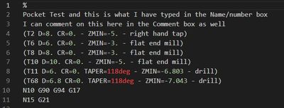

Another way to do it that I have used is as shown below, just an alternative but you would still put the Program Name in the Program Name box and a Comment in the Comments box which I find easier to use, just IMHO 🙂 🙂 🙂
I don`t know if you have any other modifications to the PP that you are using so I am just attaching this version of the PP only as an example for you to study, not for code generation use !!

There is a sample PP attached to my previous Post that will output the Program Name as it is typed into the Program Name/Number in the G code at the top as in the image below 🙂 🙂 🙂

Seems to work OK here assuming that what I have is what you want. This works in both the "Legacy" and the "NC Program" Post Processing methods, see images below, I have typed text into the "Name/Number" and also in the "Comment" box as shown in the first image, both are output as shown in the second image. Your PP modified is attached, all you should need to do is "Copy/Paste" it into your Post Processor Library that you normally use. If they need to be in Brackets (Name) for the machine control then just type them in.
