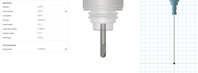

I reported two bugs/errors with the Haas NGC post that supports probing in April 2025. This is still open. This is rather frustrating as it looks like Autodesk focuses on adding new bells and whistles instead of fixing the bugs/errors that are key for manufacturing and production. The case number is 24250346.
The bugs errors involves the following:
1)  Fusion generating a message indicating that the tool length exceeds the machine specification. The error is that the calculation uses the total length of the tool bit instead of the length below the tool holder
2) The Fusion post does not accept alphanumeric file names and only accepts numbers as file names, despite the HAAS NGC supporting alphanumeric file name for more than 13 years.

Also do a test: see what happens when you increase the tool length of a tool to 300mm. If you get a warning then that post has the same bug.

1. Known bug reported to the development team earlier this year. Ideally the maximum tool length in the machine definition refers to the spindle face to the tool tip which is (Holder Length + Length Below holder) now in Fusion which is called the gauge length. Currently the Fusion compares aganist the overall length which is wrong.
