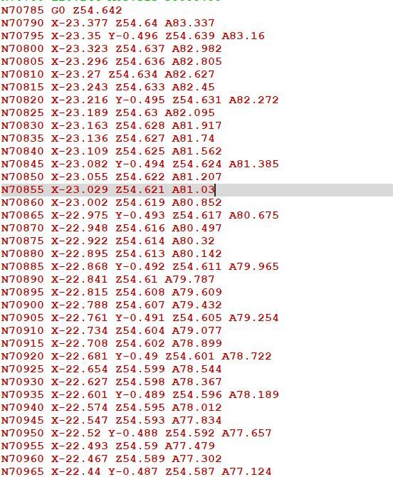

I am creating a wrap toolpath , and Fusion 360 is generating very small segmented moves , this causes too much points to be output as G0 Moves and the Haas HRT210 Rotary becomes very very very slow.
I tried changing the Tolerance , turned on Smoothing , but it still generates to many segmented G0 Moves , I found a similar post somewhere on the Forums , the solution was to loosen the tolerance and select a higher smoothing value , this solution is not working , I also changed it to Always use High Feed but then it simply generates small G1 Moves.
This small Black Points on Yellow Segment should be one single move.
Those small lines translates to so many G0 Moves in NC Code.
Any solution to this problem ? , I am attaching F3D File , I am using the Stock NGC Haas Post from Fusion Post Lib.

Yes the Rotary still moves slowly , all G0 is replaced by G1 , I checked right now. However if I manually remove those intermediate points / lines of G0/G1 Code from one plunge point to another plunge point , the Rotary moves very quickly.
Like Now :
G0 A10.
G0 A20.
G0 A30.
to G0 A90.
if I remove every G0 Line from A20. to A80. it is fast. I wonder how a Program with so many points in rapid would work on a 5 Axis Haas UMC ? Where one might have 2 additional Axis ?
