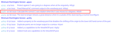

For now, you can download a previous version of the woodWOP post processor from the online library that creates the correct output for your machine.
https://cam.autodesk.com/hsmposts?p=woodwop

It looks like you forgot to attach your file, but I was able to produce a similar error when posting against a rotated pattern when the rotation center is not at the origin.  Is this the same issue that you are having?  I tried the 42987 version of the post from the post library and the position of the rotated operations are now correct.  Did you try this version?  You will notice that it is named woodwop r42987.cps when you download it, please be sure to run this post from Fusion.
We will update the library post to resolve this issue.
