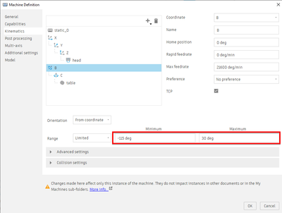

I'm using the generic Heidenhain post with our Mikron Vario600. The post mostly works out of the box but I noticed it will post B axis moves beyond the range of the machine so I modified the following line from:
var bAxis = createAxis({coordinate:1, table:true, axis:[0, 1, 0], range:[-120.000, 120.000], preference:1});
to
var bAxis = createAxis({coordinate:1, table:true, axis:[0, 1, 0], range:[-115.0, 30.0], preference:1});
This matches the machine limits of -115 deg to +30. However, when I go to post, it doesn't seem to be taking this into account. It will still post B +32 moves, etc.
Is there something else that I need to modify? I've done something similar to a Haas UMC post in the past without issue.

gsporie
I did that already through the machine builder. I have a custom made machine model that simulates accurately with the post but adjusting the limits do not seem to have any impact on the post results.

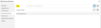

aju_augustine
Hi @gsporie ,
Is the machine linked with the Heidenhain post?
if the problem still persist, could you upload the machine file here?
Aju Augustine
Technology Consultant
gsporie
Yes, the post is linked to the machine in the machine definition
