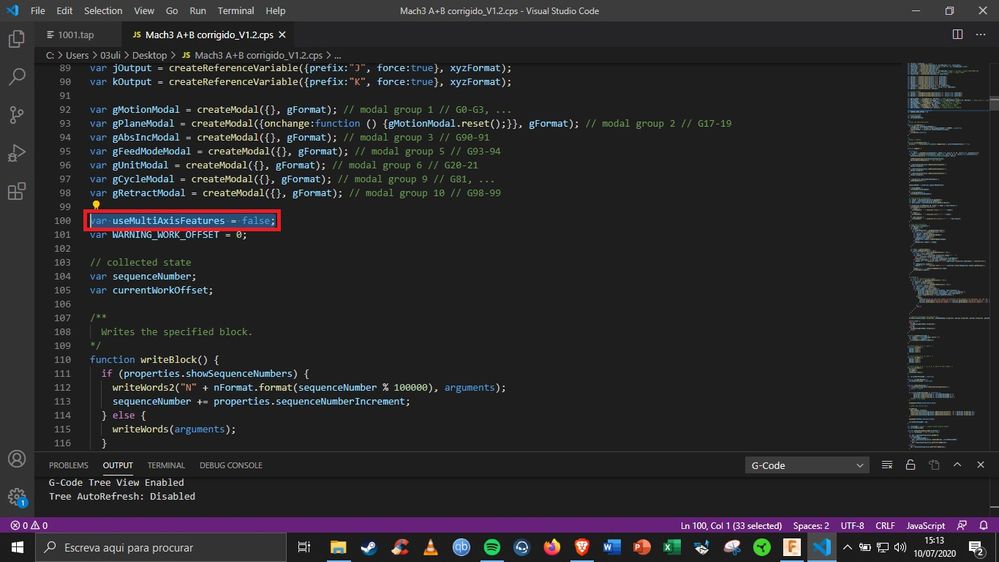

My post processor did not had that line, but i added it and did like you said but it is still the same 😕
I attached some prints to explain better the problem.postp.jpgg55.jpgg56.jpg

This does not work on machine because, it does not have have functions like DWO. So i just adapted the post-processor to let me add manual G-code lines from fusion and i solve this issue.
Capturar.JPG Anyway, thanks for the help.
