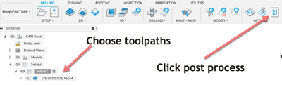

I'm getting the error that Radius to end of arc differs from radius to start. Can someone help me out with the settings I should change around? I've never gotten this error, and I don't really understand much about G-Code, I just use the software. I read other forums about this problem where some people suggested to change the tolerance to .0001, as well as check "radius arcs" in the post processing tab, neither of which worked. I've attached a screenshot of the error message and my file.

Sure, to use the CPS file I attached above, follow these steps:

Hi George, I used the post processor you provided and I still got the same error message

@derinveron  After setting vertical lean in radius to zero, did the control error on the first arc move or did it error later in the program.

Hello, just updating that the issue seems to have been fixed by changing the post processor from LinuxCNC EMC2 to LinuxCNC EMC, in conjunction with getting rid of lead-in and lead-out radii. I know I tried unchecking those radius settings in my original post and it didn’t work. In case anyone else has this same problem
