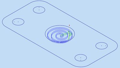

From picture
Normally, when we used pocket not active Predrill Position. I will get G-Code have plunge feed & cutting feed.
When I active Predrill Position.
I will get G-Code do not have plunge feed.
For my need. (Post is Fanuc)
Can I have a plunge feed & cutting feed when I active Predrill Position?
Please suggest

ballnr
Right now. No solution to solve it.
Normally, if hole Predrill is thru all, that G-Code when we have it from post is ok.
Because that use feed cutting, it fast no need feed plunge.
But in case of Predrill is not thru all, we will have some problem when cutting high at level angle of drill tool.
Please help & suggest.
Many thanks for your support.
ballnr
Please help
seth.madore
This is not a supported feed type when using Pre-Drill, as it is designed for when you have a Predrill or a Plunge (with an Entry Point define). I don't see us changing the first, but I can see a case where: if Plunge and Pre-Drill point are defined, we adopt Plunge Feedrate. I'll open a ticket, but it's not something I expect to see resolved in short order (priorities and customer need drive that)

seth.madore
It's also worth noting that the 2D Adaptive is behaving as you would expect it to, so perhaps that's a temporary solution for you?
