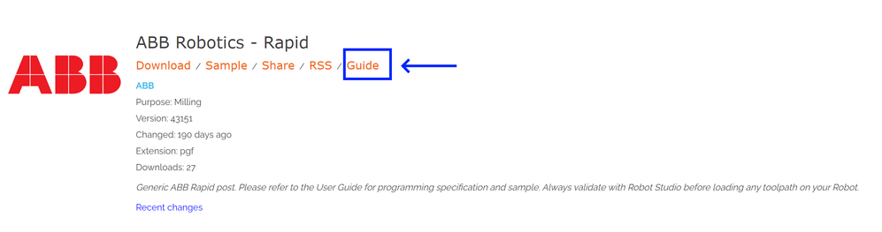

Hello everyone,
just started working with fusion and right now i'm involved in a new project.
We are printing filament with an 1mm (or 0,4mm) nozzle with an ABB (IRB 2400, IRC 5) robot right now.
We would also like to mill directly on the printed object afterwards. We used the Fusion proramm and replaced the quaternions and robotconfig (of our tool, the position at that moment where it should mill) manually, cause the ones from the Fusion programm were useless for us.
That worked in one case pretty well.
We did that (enter quaternions & robconfig), because we find no way/solution to enter our tooldata from the "real tool" on our robot into the fusion program. Is there any way to enter the tooldata into the fusion programm (in no way dependent on how the tool is mounted) ?
Thanks in advanced.
Greetings Tim
Message 42 of 84
stefanie.pender
Hi @Anonymous
Right now, there is not a place to insert the tool data into Fusion 360.  Usually I teach the tool using the robot's teach pendant manually - for example I teach tExtruder.  From the Fusion 360 program I then input this tool name in the Fusion 360 post process window.   Instead of the default tADSK for the tool name, you would insert tExtruder or whatever you name your tool.  Make sure that the line with your tool data (in the ABB controller side) is pasted into your Fusion posted program.  For example this tooldata code needs to be included in your program:
TASK PERS tooldata tExtruder1:=[TRUE,[[318.77,27.4718,589.449],[0.0241187,0.92308,0.0133704,-0.383618]],[30,[156.721,-1.367,286.476],[1,0,0,0],0,0,0]];
Here is a video where I go over the entire process of the Fusion 360 to industrial robot workflow.  I teach the tool at around 22:00 in the video.
https://www.autodesk.com/autodesk-university/class/Learn-Rules-Then-Break-Them-Fusion-360-Industrial...
The handout for the course explains tool data on page 12 of the .pdf.
Let me know if you have any more questions or if you need anymore clarification.

alexandre.pintoAGNAU
Hi @Anonymous
I would add to what Stefanie has said to make it extra clear.
Fusion 360 Robotic toolpaths have 2 possible tool orientations, so you must configure your tool in this way or the toolpaths you post will not work as intended. There is no way to use other tool orientations other than the ones detailed, so no way to reverse engineer a tool. I hope this is clear!
Besides the tool the part workplane (WorkObject) must be defined in the setup to replicate the workplane defined on the robot.
All this is detailed in the documentation available, so please refer to it for help.
The video Stefanie shared is very complete and clear.
I hope this helps.
