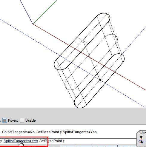

See attached, I get this sometimes. This is a 2d pocket. The path is obviously wrong. Anyone know the cause?
More info, it's not the tool path it is the imported part has lost the proper radius. Rhinoo file and also a stp is the same.

Back again, had to pay some bills. Attached is a png with the left curve drawn in Rhino and the right curve drawn in 360. The 360 curve produced a better tool path but the resolution is bad (how do I fix that?) the Rhino toolpath is wrong and although I can't see it I believe the curve is distorted and the toolpath is just following what's there. The Rhino file is attached. I read the conic curve issues and I think this is along those lines and I guess the fix was to draw in 360. I am trying to do that but I need to fix the resolution issue before I go anywhere with it, I guess it is a setting that I have missed? Thanks for the help!

The problem is you've extruded the slot as one surface this can cause problems with a lot of programs. What you need to do is select split at tangents when you extrude.
This is a pretty simple part, why don't you draw it in Fusion.
This is what I get after using split at tangents in Rhino then exporting as a stp file to Fusion.
Rhino file attached.

Success, a bit anyway. I tried drawing in 360 and I spent hours trying to create what I could do in Rhino in a few minutes. I extruded the surfaces from a split curve and exported the Rhino file with the surfaces not joined. Seems to have worked perfectly, at this point anyway. A proper looking tool path.
