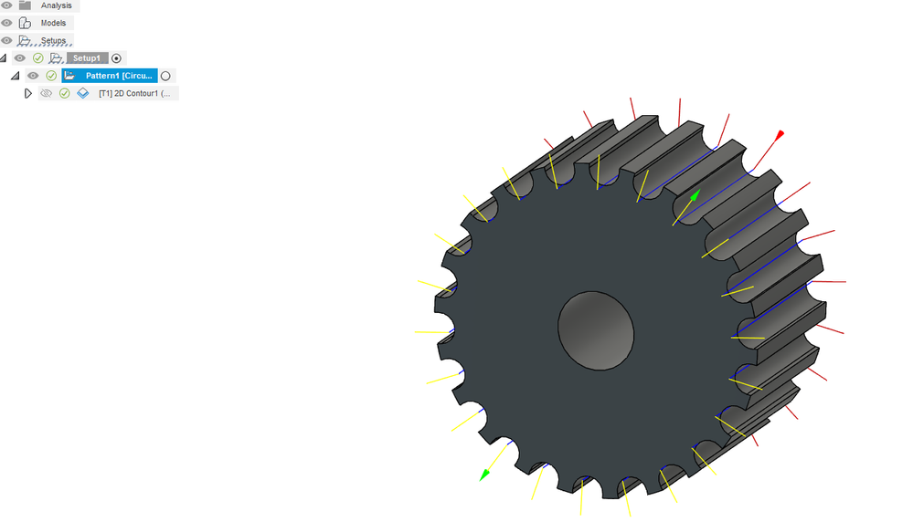

Anyhow, I need to find out to what extend I can use the 4th axis of my machine from fusion. Part of it can be to see if/how I can create toolpaths for parts like shown in the screencapture (3M-100-12 pulley), where most of the stock preparation is done on a lathe, only leaving the cutting of the teeth to be done on a CNC mill. The geometry clearly points in the direction of a 4th axis...
If you would have any suggestions on how to approach this within the limitations of the basic commercial license, that would be very much appreciated. Flanges can be omitted (added later on).
One of the possible solutons I already have working is creating two halves (cut radially), which needs no 4th axis at all.

seth.madore
In cases such as this, the flanges are typically pressed/welded on afterwards. Otherwise, any tool you bring into it would leave a fillet at the ends.
For this part, assuming the flange isn't there, there are two approaches I would take:
1) Use a Ball Endmill, position above the part, center of X. Cut each tooth, rotating the A axis for each new tooth
2) Use a full radius Key Cutter, approach the part from the negative Y position, cutter placed right at the equator
In both instances, all you need to do is program up one instance of the tooth and put that into a Pattern > Rotation and state the amount of instances to rotate. Rotary Toolpath is not required for this

Now practically, I still miss something related to : "In both instances, all you need to do is program up one instance of the tooth and put that into a Pattern > Rotation and state the amount of instances to rotate. Rotary Toolpath is not required for this"
==> I know how to us pattern on sketch level, as wel as on object level in design, but how does this translate into A axis movements in manufacture?

johnswetz1982
On the CAM/Manufacture side, once you do a setup any operations with [Tool Orientation] look at the difference between Z+ for the initial setup and Z+ for the operation. Fusion figures out that difference and outputs the axis movement required.
Example: Initial setup with no [Tool Orientation] is A=0.0 and the 3 follow up operations that are patterned put out, A=90.0, A=180.0, A=270.0
2 Tool orient and repeat.JPGLeft side
1.JPGTop
In this last example, initial setup would be a blue arrow pointing to the left (Z up) while this operation is tilted at 45 degrees so Fusion knows to put out B=45.0 for this operation.

seth.madore
And here is a sample of Patterns in the Manufacture environment:
Seth Madore
