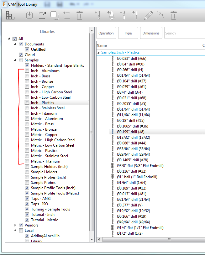

Hello, I just start using 360 and CAM function, but I notice than no drill setup are included into Fusion regarding wood material or Foam material.
I'm planing to used a 80kG/m3 Polyurethane foam but I can't find any setup for this type of material. I was then looking for wood, but there is no wood drill setup neither.
What should I do then?

Are you asking about in the sample tool libraries?
Currently, we don't have sample wood or foam libraries, but you may be able to use the Plastics samples. However, I am sure you can find some appropriate feeds/speeds for these materials online somewhere and could then define your own tool. You could even copy one of the sample drills that are there to your document and modify the speeds/feeds on that copied tool.
Hope this helps!
Noah

some reading for you
http://precisionboard.com/product_users_tooling/speeds-and-feeds/
https://www.toolstoday.com/p-6221-solid-carbide-spiral-foam-cutting-up-cut-and-down-cut-router-bits....
