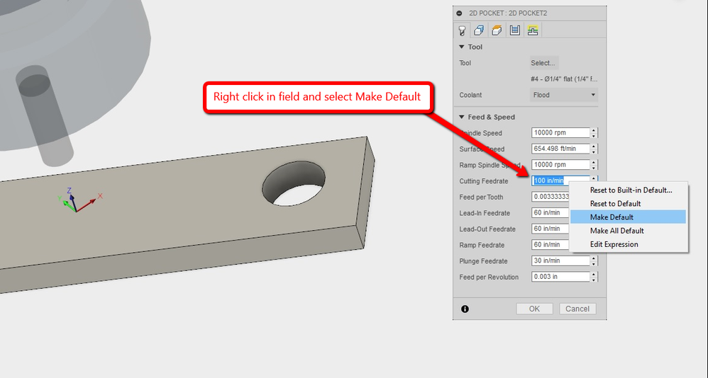

@stuart Thanks for posting your question to the Fusion 360 forum. To maintain a default of a parameter in the CAM environment, right click the highlighted field and select Make Default.
This should maintain that parameter across operations. Give this a try and let us know if you have any other questions. Thanks!

@stuart You should be able to just enter the feed rate that you want and then right click and select Make Default. You shouldn't need to enter an expression.

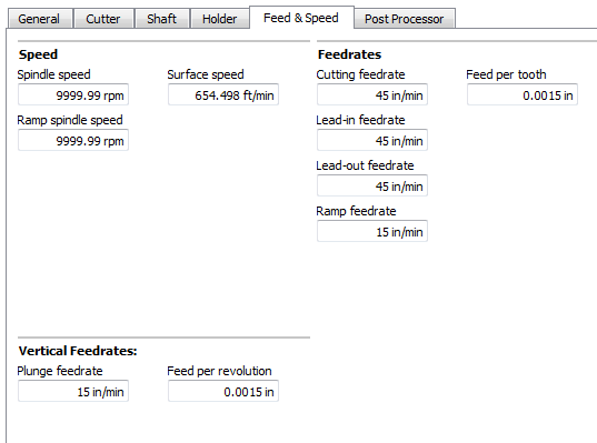

What values do you have in the tool definition itself? Perhaps this is conflicting with the toolpath settings:

stuart
I think this could be the problem. I have values in all tools.
