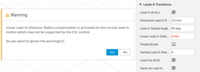

Hi all! I have a problem with the Fanuc post processor in Fusion! In the G code, all compensations (G40,G41, G42 and sometimes G43) come out in the following format G01 G40 (G41, G42,G43) X...Y ...; and this, of course, gives an error! It also started giving me an error PS 0034!

I referred to the Fanuc alarm code list, and it states "An attempt was made to perform a start-up or cancel of cutter
compensation or tool nose radius compensation not in the
G00/G01 mode. Modify the program."
FANUC requires that cutter compensation (G41/G42) or tool nose radius compensation be activated or canceled only during linear interpolation (G01) or rapid positioning (G00).If your program tries to turn compensation on/off during an arc move (G02/G03) or any other mode, the control will trigger PS0034.
When your compensation type is set to "In Control", then your linear lead-in distance has to be greater than zero.
Anyway, even when I posted the code after ignoring this warning, still compensation is switched on during linear movement.

My machine is First V700 with Fanuc 0i-MD
N345 X-102.803 Y49.905 Z-1.
N350 G41 X-88.108 Y29.68 D04
N355 G03 X-85.873 Y29.326 R1.6
N360 G01 X-24.744 Y73.738
N365 G03 X-24.104 Y74.783 R1.6
N370 X-24.39 Y75.973 R1.6
N375 G01 G40 X-39.085 Y96.199
That is a part from the program....Here give me Modal blok stop alarm
jodyF8L9L
Do you know what the code should look like? For example:
VS
G40
G01 X-39.085 Y96.199
VS
G40 G01 X-39.085 Y96.199
If so, the post processor needs to be edited, particularly the "onLinear" and/or "onCircular" functions. If not, you may need to adjust the lead-ins/lead-outs. That can be time consuming...went through that with a precision bore...was hard to nail down the lean-in/lead-out parameters when using cutter comp with a large cutter in a tight bore.
