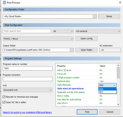

I would like to know if its possible to make Fanuc milling post processor support retract heights to clearance height , like in this Siemens 810D post processor:
I want that because every time I use multiple offsets, spindle goes all the way to the top from one offset to other and I don't think its necessary:

Hi @Martema ,
The Clearance Height Safe Retract is already configured in the post. The only thing is you need to remove // and add, as shown in the following user-defined properties
  safePositionMethod: {
    title: "Safe Retracts",
    description: "Select your desired retract option. 'Clearance Height' retracts to the operation clearance height.",
    type: "enum",
    values: [
      {title: "G28", id: "G28"},
      {title: "G53", id: "G53"},
      {title: "Clearance Height", id: "clearanceHeight"}
    value: "G28",
    scope: "post"
For your second  question: Is it possible to call tools by their name instead of calling them by T01? Yes, it is possible. But I haven't seen any Fanuc controller which supports Tool description instead of Tool number.

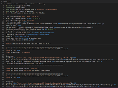

I changed my PP like you mentioned, but now there's another problem.
I'm getting this error: Cannot cancel length compensation if the machine is not fully retracted.
KrupalVala
Hi @Martema ,
You can ignore the error by adding // in the validate line.
function disableLengthCompensation(force) {
  if (lengthCompensationActive || force) {
   // validate(retracted || skipBlock, "Cannot cancel length compensation if the machine is not fully retracted.");
    writeBlock(gFormat.format(49));
    lengthCompensationActive = false;
 Make sure how the code performs in your machine without G28/G53.
