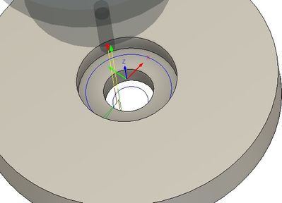

good morning,
it is possible to join two different paths in a single path, to avoid outgoing junctions between the two operations.
Using it milling holes in the drilling path as the first operation and as a second operation with the same tool number I use the 2D contour path, I would like it to avoid outgoing junctions between the first operation and the second.
thank you very much

engineguy
@marco_bazzali
See image below, is it what you want ? It can be done using both the 2D and 3D Contour.
You can play with the heights andturn off the "Rapid Retract, all very messy and not something anyone would recommend 🙂 🙂 🙂 Example file attached,
