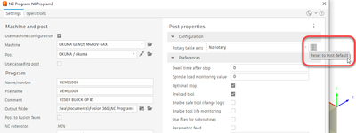

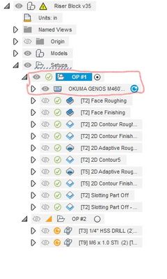

I continue to get this error across parts, and I am at a loss. In this most recent case, another user was able to get a correct post output where I cannot because machine definitions are not being referenced correctly. I sorta understand the issue, the post is doing what it knows to do, correctly, but I am messing up somewhere to where the post does not have set limitations and parameters.
As I currently understand it, inside of a setup, I select a machine, in this case an Okuma M460-5AX, and continue on about my day. However, when I select post process, in order to have it not fail, I end up deselecting "Use Machine Configuration," thus removing any machine definitions and parameters it could use to correctly output a program.
Screenshot 2024-04-18 103606.jpgScreenshot 2024-04-18 103818.jpgScreenshot 2024-04-18 103940.jpg

Hi @Eric.Moore24 ,
thanks for your feedback.
The problem here is that you have the property "Rotary table axis" enabled and its set to "5 axis".
What this does it enables predefined machine kinematics into the postprocessor. Of course that conflicts now with the machine definition your selected into your setup of your Fusion project.
When you set this property to "No rotary", the error should go away and the postprocessor will make use of the machine you selected in Fusions setup.

Okay, I just did all of that, but I am still getting the same error message.
I thought that it might be my second setup not being complete, and not having a machine selected. I just went through and did all of that only to just get the same error.

AchimN
You can additionally try to use option "Reset to Post default" in the property:
Then you must postprocess an NC-program so that Fusion saves that state of the property. Then try again to use machine simulation.
