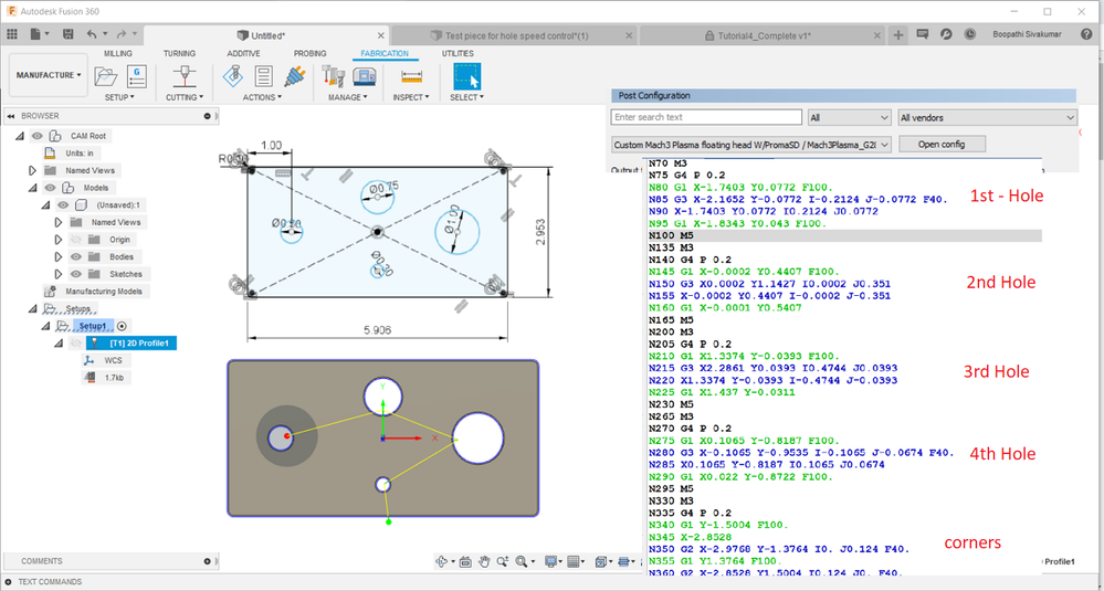

I would like to know if I can make a rule or a change to my post processor that will change the speeds for small holes to improve the cut quality. say any hole under 1/2" I would like to reduce the speed by 60%. Many other programs have this function and is very time consuming to pick out the holes individually to generate the proper code.

The post can be manipulated to get what you have wanted but it also depends on the arc you are selecting sometime if you are working with other CAD data files due to the tolerance post cannot be able to get the radius in that case it may not work but for clean arc it will work perfectly
function onCircular(clockwise, cx, cy, cz, x, y, z, feed) {
  var getRadius = Math.round(getCircularRadius())
  if((getRadius) <= 6.35){
    feed = feed*0.4;
  if (pendingRadiusCompensation >= 0) {
If you go to function onCircular you could add the codes like above this will reduce the feed by 60% if the circle dia is less than or equal to 1/2 in. Check and let me know the feedback
Boopathi Sivakumar
Principal Technology Consultant

I installed the code snippet. However, it is not working for me.  (New Model)There are two holes and two radius's both holes are larger than .5". One is .8" and the other one is 1". these should cut at 100"/ min.  The radius's should drop to 40. all of the radius's are at 40"/min.  I have inserted the G code. and the Post. Maybe I did not insert the Code Properly. I will continue to mess with it.
(Circle speed control)
N10 G20
N15 G90
N20 G92.1
(2D Profile1)
N25 M6 T1
(.08 tip 16ga/61 thc volts/30 amps/ 80"per min)
N30 M9
N40 G0 X1.2453 Y0.9424
N50 G28.1 Z 0 F10
N55 G92 Z 0
N60 G0 Z 0.15
N65 G92 Z 0
N70 M3
N75 G4 P 0.2

boopathi.sivakumar
@Anonymous
I had no problem with my end  checked a new sample which has holes you can see in the image, I used the same cps file you have attached over the previous thread
You can clearly see its running as per the rule which we had set. i don't know you are having the issue, Kindly check it again if its not working could you please share a screencast video of process of creating the nc file
Boopathi Sivakumar
Message 11 of 11
Thank you it works well. Like I thought I installed the code snippet incorrectly. It now works Fine.
I Tried to create two variables for Properties that would give a Person the ability to change the setting in the Post without Modifying the Post. I think this would help People in the future. However I could not get this right. Would you be interested in doing this as well?
I have modified this Post to Run MACH3, Proma150 Sd, floating head and with a smooth stepper controller. a lot of people run this combination.
