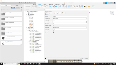

Hey everyone. doing a lathe setup in fusion 360 and everything is cutting towards the chuck which is good, however when I cut normal right hand threads, the tool is cutting away from the chuck and I don't want to pull the part. does anyone have any thoughts on this? Im trying to cut 3-1/8" UN threads

You've defined a RH tool and RH threads? If those are both correct, it should be cutting towards the chuck. If it's not, could you share your Fusion file so we can see your settings?

see file below. I just switched to RH tool as it was set for LH tool. I am trying to cut 3-1/8" 12 threads on the flat surface. Please note this original file was drawn in SW

You had the "Clockwise Spindle Rotation" turned off.
Assuming you ARE using a RH tool, you'll want to turn that on and define your tool as a RH. Travel will be into the chuck

Ok we were able to get the tooling to move towards the chuck but we are still not getting threads to show? Given we know the tool holder we have shown holding out insert may not be correctly drawn since we modified it to be similar to our actual Iscar tool holder but we still aren't getting threads to appear. see screen shots below.

In your toolpath. you have your pitch set to 12 inches and then your tool is defined as a .012" pitch. Neither of those are going to get you good results. Let's change those to be correct and see what we can see:

Pitch should be .0833

So we set the tool pitch to 0.0833 and the pitch in the pitch in the "passes" to .0833 and we got something that looks better but is still showing contact gouging or "rubbing" on the end thread closest to the chuck as shown below? Any way we can clean this up? Also can you tell me where you got the (0.0833) for pitch?

1/12 = .08333
To calculate the pitch (in Imperial), it's just 1 divided by the pitch.

it appears in my image above, that it is gouging or recutting that last thread to be too wide/deep. we have it set to do 7 passes at .0255 thread depth with a spring pass using can cycle. how can we clean this up?
