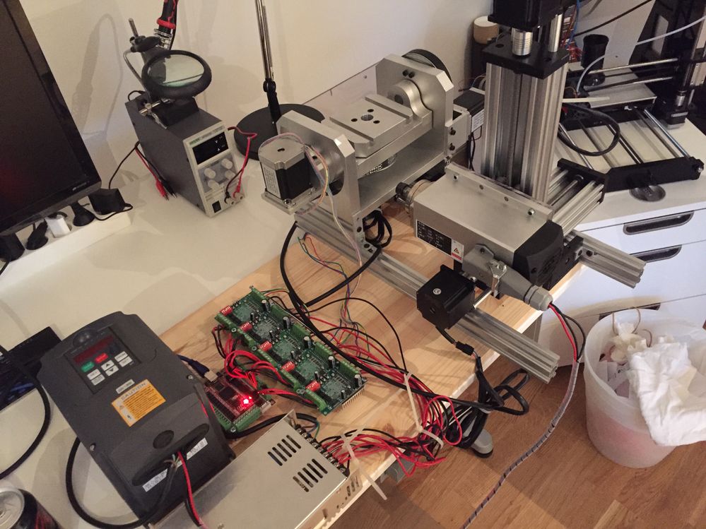

Hi im about to finish my custom designers 5 axis cnc, the design is similar to pocket nc.
What im wondering is if im using fusion 360 for all the CAM work, what are my options for finding the work piece?
One thought i had was using an electric zero button for the tool and then if i know exactly where the center of the b axis is based on the machines zero it will know where work piece is.
maybe there is some better way, anyone that can help me out?

Yeah i have the axis the same way as that i just was a little inside about positive or negative on zIMG_1200.JPG
The z axis is a little hard to see behind the spindle..
any idea on the collision question?

Wow that looks like great progress on that machine.
As far as collisions I have a pause button I can hit that suspends all motion. And you get a pretty good idea after jogging you machine and then running it where it starts from and where it should be going. As an example, I do a lot of 3 Axis machining. And it requires the A set to 90. So that is one of the first things that happen. And then it engages the envelope of my part with approach move. If it looks to be in the ball park I let it continue. If not I figure out what I did wrong. When you get into 4 Axis it's also very similar you know the approaches and motions and if it looks ok proceeed. Early on I did nick my table by not realizing there was an impending crash in the works. Since then I've been cautious to learn where the machine typically approaches from and finishes at.
Last when all my programs finish I have the spindle returned to HOME Z and then XY to HOME Z then I move the A and B tables home. And now I cut unattended for hours on end no problem.
