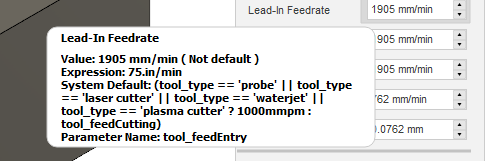

Rob, thanks for putting the work in to create this list from HSM works!  One tip i came across that may or may not be known is that if you hold down the SHIFT key before you move the cursor over a numerical entry box in the toolpath parameters you will get the parameter name, defaults, value etc.  Also when you edit an expression and start typing it will pull up a list.  So even if guessing you should get pretty close to the right expression.
I looked up a few in your HSM List(which is over a year old but this thread pops up in a search at the top) and have seen that some are different so using the Shift key trick should help get users close that are looking for an expression list for Fusion and find this thread.
Below are some screen shots from holding down the SHIFT key over various inputs in an Adaptive toolpath.
