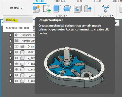

OK  so you need to go to the machine library and  right click, edit the machine in machine builder
then switch to design:
Turn on the Origin, select the entire machine and then press M for Move
Set it to rotate, and select the Z axis as the rotate axis, then rotate it the direction you need.
Switch back to machine builder and confirm that the correct components are selected for X and Y etc
Check using Preview Machine movements that everything is moving correctly
Then Finish out of Machine builder to save the changes.
You will need to re select the machine from the Machine Library in your parts Setup to update it.

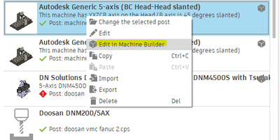

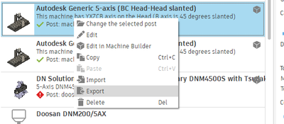

inflameWBW5X
oh dear.... edit in machine builder is greyed out.
a.laasW8M6T
Hi
I didn't realise this was one of the autodesk generic routers.
There is already one in the Fusion Library with the XY in the orientation you want.
the one you have Picked is the XYZ on head
You need to pick the one that says YXZ on head
Also, you don't actually need to pick a machine in a setup to create toolpaths, its just a nice to look at thing for 3 axis work

inflameWBW5X
Oh wow that's excellent.
Hard to spot the difference XY or YX, even had to read your post 3 times to pick it up.
Well that sorts that out. Thank you. Still have more problems to deal with but at least I can move on now.
