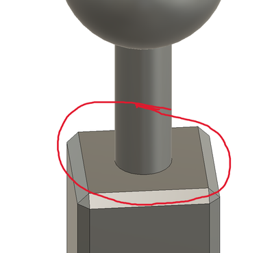

In a 5 axis machine, how can I process the end of the cylinder shaft in a 90 degree way?

It is not at all clear what you are asking or what issue you're running into. Would you be able to share your Fusion file here?
File > Export > Save to local folder, return to thread and attach the .f3d/.f3z file in your reply.

I want to process the marked area according to my design

I'd suggest using a Rotary Parallel toolpath:

The problem I'm facing still persists, I can't process the 90 degree angle at the point where the cylinder shaft connects to the ground. In the photo you shared, you shared a program that processes the middle part of the cylinder shaft.

You're looking at finishing the diameter/face intersect, right? The toolpath that I showed above goes right to the edge, what you're seeing is the centerline of the tool.

Thank you for your support, I have reached the result.
