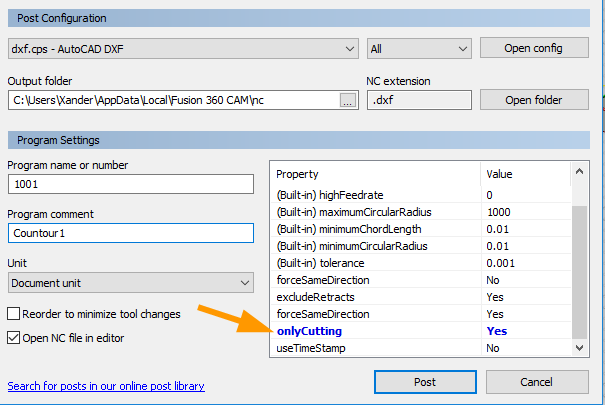

Hi all.
I need to find a post for a Calypso water jet.
apparently this machine uses NC GeoMate http://multicam.ca/nc-geomate-software-for-waterjet/
to automatically create its own cut program and basically you feed it a dxf and it does the rest.
how ever we have tried supplying the sub contractors with a dxf created by fusion! but no luck in the DXF export from fusion being able to translate into the sub contractors cad package.
Now I don't know if this yet another fault of the fusion sketch engine! But I need to get these bits cut like last week!
So the solution was to try and output a program from fusion!
I can't find a way of outputting a program!
Has anyone got experience of the above water jet! is there a post that will work!
Apparently a Multicam post should work but all i get is this!
As you can see. drawing a bit of a blank here!
Some help would be greatly received!

Error: Waterjet, laser, and plasma cutting toolpath is not supported by the post configuration.

Hey there!
You said the software "automatically create its own cut program and basically you feed it a dxf." So you are looking to export a DXF of the toolpath, however you used a Milling Post processor which creates gcode. I would recommend downloading the DXF post processor from here: http://cam.autodesk.com/posts/?p=dxf
Save it to C:\Users\YOUR USER\AppData\Roaming\Autodesk\Fusion 360 CAM\Posts
or somewhere else.. just DO NOT save it with the generic posts.
For you waterjet operation, you can leave the tool tab at it's default settings (waterjet cutting, through -  auto, .08 kerf, etc.). Select the geometry/edges/contours you want to export to be cut, heights can be default as well (we're going to discard all that data when we export to DXF anyways), then go to the passes tab and change the compensation to center instead of left.
9DEb6lw
This prevents it from applying the kerf offset to the part since the other software will account for the offset.
Lastly, under the passes tab, disable lead in and out so those don't get included in the DXF file (just uncheck the boxes.)
Now post your operation and choose "Personal Folder" to load up your personal posts
9HIFCE2
Lastly, change the "onlyCutting" option to Yes so that only the toolpath is output to the DXF file since the other program will create the linking movements. Save to wherever you please and enjoy your Autocad DXF.
CmqZTbM
If that doesn't work you can try using the Universal Laser DXF post processor instead, but you'll need to change the operation to be laser instead of waterjet.
Let me know if that works!

daniel_lyall
@Anonymous the other option is there is a plugin for exporting .dxf files here for lasers but it can be use to just export a .dxf https://apps.autodesk.com/FUSION/en/Detail/Index?id=7634902334100976871&appLang=en&os=Win64  it only export one face at a time but it's a very clean .dxf
