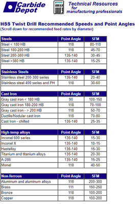

programming2C78B
I'd like to see whoever at fusion is running regular drills at 300sfm in aluminum!
Please click "Accept Solution" if what I wrote solved your issue!
Don.Cyr
Typically we use 350 SFM as a baseline for HSS drills in 6061 aluminum.. Not here to make fun of you but there are many resources available to help you if you are unsure due to not having much experience.
