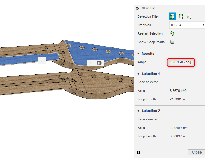

LibertyMachine
Hmm, not seeing the issue:

LibertyMachine
That's because the fingerboard area is not along the same plane as the Headstock. You selected the Fingerboard area in your Setup. Try selecting the Headstock area and you will be fine

I am having the same issue with the bore tool path not working with an empty message log... i have used this tool path with a similar set-up successfully many times. There are some differences that should be noted, I have converted all the bodies into components. I then copied each component for a multiple of 2 of each set I did not paste as new though so they are connected, however as far as I knew the CAM should only be concerned with the model itself and not with the bodies' dependency on the parent component.bore toolpath no beunobore toolpath no beuno

thank you for your reply... I ended up figuring it out, kind of. Even though I aligned the pasted component to a body derived from a native plane, it was out of whack somewhere along the lines. Instead I re-pasted and used the move tool, point-to-point, instead of the align tool, it worked and my parts are on their way. Hope my hair pulling helps someone else...
You should use joints for this, of course you also would need all parts as components as well. Both of these are best practice, use components, avoid move\align and layout using joints. Reading your first post you should be designing using Rule#1, converting bodies into components is not a good idea.
