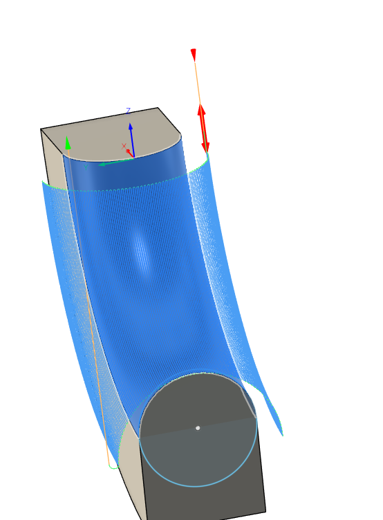

Hi, please refer to picture below.  This is all I can share, but if you know the answer, that will be enough 😬
The picture is self explanatory, I cannot achieve the goal.  There are reasons why I need to start specifically from that corner, there are parts of the model that are cut off, but starting from where it starts is a problem.
Any help really appreciated!

I understand the order of the curves we pick decides from what curve the path starts.  This is not the issue, it's more, at which end of the chosen curve it starts, I cannot control it.
You are showing a nice red arrow to click on, but for me, I get a double ended arrow, and no matter if I click on it, it has no effect.  See picture below, seen that before?

@DarthBane55 Sorry for confusion. I'm using slightly different version of Fusion360 and see two arrows (single arrow for each contour and it's possible to change direction) but it's "double side" arrow in production version so you're right.
