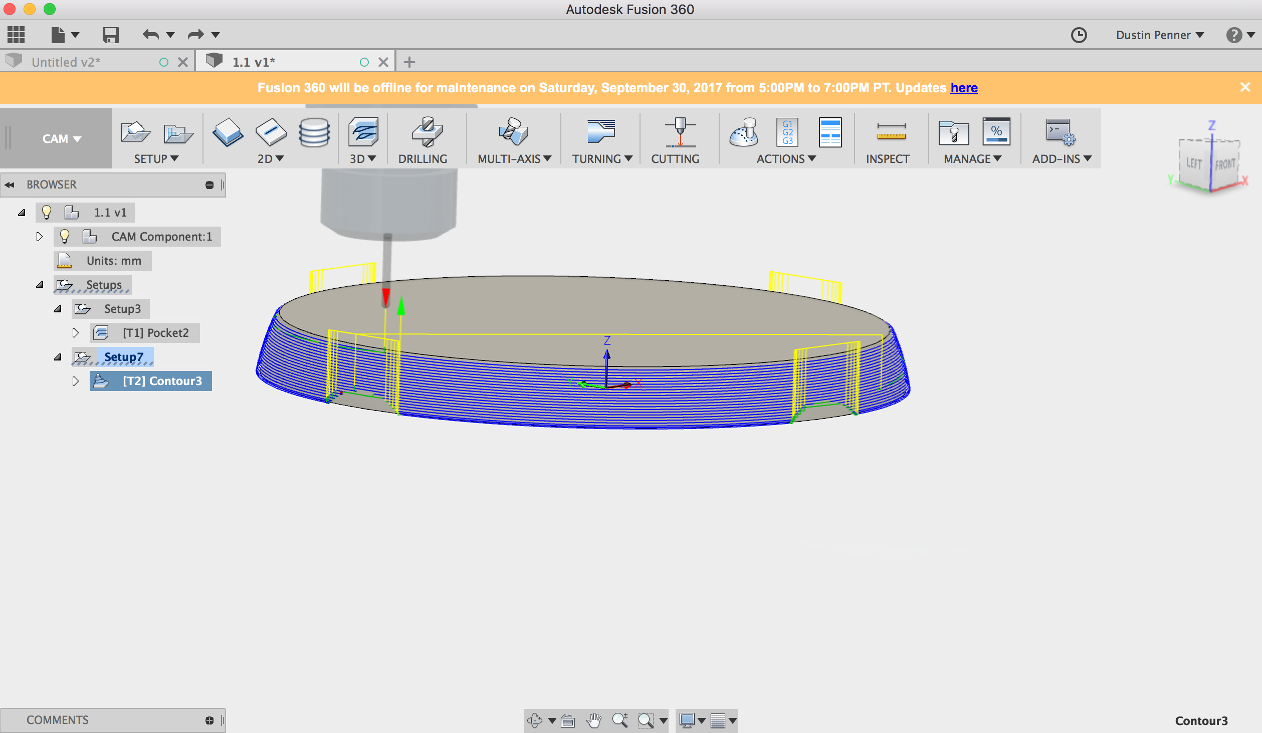

I have only been using Fusion 360 for CAM work a few days.  I am trying to cut out a fairly simple shape with 3D Pocket Clearing followed by a Contour pass.  Everything is working fine except there are tabs on my piece that I don't want and I can't get rid of them.  I have looked everywhere for tab settings for 3D operations but so far have been unsuccessful.  I did not add them they just showed up in the tool path.
Any help would be appreciated, please see pictures.

Thanks for reaching out to us. Can you please share the design with us? Just click the File --> Export command and then export the design to be an archive format .f3d and put it here? The detailed parameter settings will help us the analyze this case.

Hey Debbie!  I've attached the file here.  Thanks in advance!
I guess I just needed a strong cup of coffee and fresh eyes to solve the problem...  I had "stock to leave" in the passes tab set to .5mm and as soon as I disabled that they went away.  I guess they weren't tabs, but they look like tabs and would have acted the same.
