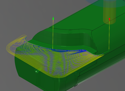

Greetings,
While adaptive clearing, I prefer the tool to not retract, & just move around in the X & Y.
Even tho the options are selected, the tool still retracts.
The maximum stay down distance box doesn't work properly, bc it thinks the rapid motion violates the work piece???
The only thing that seems to have an effect, is the tolerance box under the passes tab, & that's always a toss up.
How can I  keep the tool down?
This becomes a big issue when I'm working w. a longer tool & a the indexer is @ B0, & fusion is trying to retract a tool that would alarm the machine out mid operation.
Thank you,

sewais
Seth,
Yes, but I can rotate the C axis @ B0 under Tool Orientation to make the tool enter on the tool change side of the work piece & exit on the same side too. The exit can be tricky.
example:

Message 10 of 22
sewais
I managed to get it to work by changing the Tolerance box (under the Passes tab) .0001 at a time as well as the Horizontal Lead In/Out Radius (under the Linking tab)
Seem to be doable w. minor tweaks, but I'm not sure why it doesn't work from the start.

Message 16 of 22
sewais
Yes, certain fields need small tweaks of .001", there are many of them that can stop the retracts like Tolerance,  Optimal Load, Radial Stock to Leave, Horizontal Lead in Radius, & some others.
What I found to be the most effective is choosing Silhouette under Stock Definition, that seems to work almost every time, but of course its not always the best choice for the actual operation.
If you read in the explanation bubble of Maximum Stay Down Distance, it says regardless of stay down distance, the tool retracts if the rapid motion violates the work piece. This is the issue I think.
Worth noting, having the ability to 'drive' the machine using one dial for all moves is very handy for first time run parts. I can keep the rapid dial at 0 while controlling the feed dial only (Okuma/OSP). I know retracting is faster, but speed isn't everything for low count parts where clearance is tight.

Message 19 of 22
andrew2085
Not stay-down distance, stay-down clearance, the box under it.
Message 20 of 22
sewais
It gets worse. Some screen shots below:
Before:
After:
