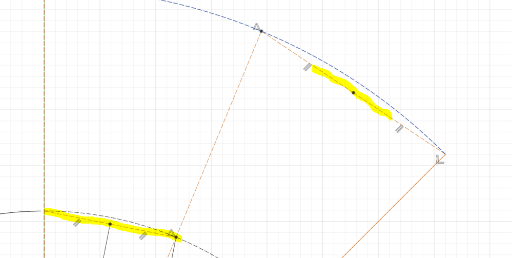

I need to create a line, the same length as another and with it's midpoint matching the midpopint of another line.  (Picture probably show this better).
The highlighted portion on the right needs to match the one on the left.The highlighted portion on the right needs to match the one on the left.
I can do this with some fancy footwork creating a derived parameter and then setting all of then as the that parameter, is there a simpler way though?

Hi @banksysan,
You can also use the equal (=) constrain.

That ensures the lengths are the same, but not the positioning.  I still need it to be centred on that arc.

Hi @banksysan,
Make the end points Coincedent
A other option is to use circular pattern the left lines around the center.
