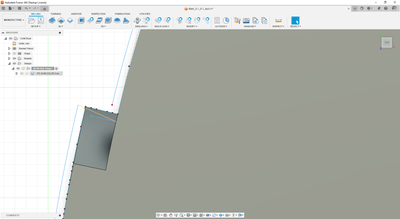

There was one file at the top of this topic.  Another one is linked here.
Below is an image of the problematic area.
billoStratum
