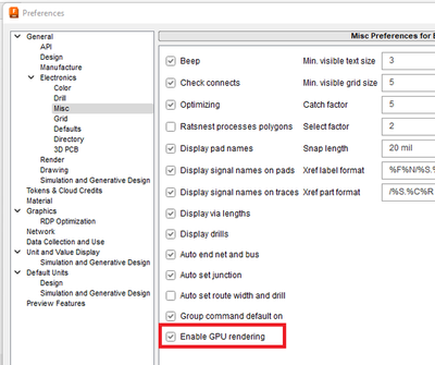

Dear @furaTT4KY , @pawabramowicz2003 ,
Good news that today we released new Fusion version 2.0.15995 which has fixes about below issues you reported about GPU rendering, including:
  • Black Canvas in some Windows OS with integrated AMD graphic card
  • Canvas refresh issue in Windows OS with Intel Iris Xe
  • Customer Font not showing well
  • Slow performance in some Mac Intel OS which ONLY has integrated graphic card
  • Overlapping polygon and rotated device issue
Could you please update Fusion to new version and go to preferences dialog and check the checkbox to enable the GPU rendering and relaunch Fusion to take effective?
Please feel free to let us know if you have any problem about the new version.
Much appreciated for all your feedback and patient.
Hope you have a great day.
Best regards,
Helen
